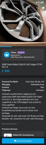

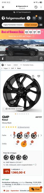

I would take the ET45 since it is on sale.

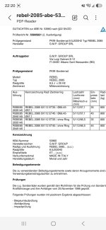

I took the time to go through the ABE of the Rebel. In ET45, these not for the Formentor approved, no matter which engine you drive.
If you like the rims, you need to order them in ET35, then they have an ABE.
Alternatively, you can do a single approval of the rims in ET45 at the TÜV, but no one can guarantee that they will be registered.
ABE GMP Rebel
10 mm spacers would increase the chance of getting a TÜV approval, but individual acceptance and spacers negate the price advantage of the rims. Basically, everyone tries to drive with as little ET as possible and to avoid spacers. The fact that the rims are so cheap probably has its reason, and this should also be considered during later resale. It's better to buy the more expensive rims and be on the safe side, because if you don't get an approval, the fun will ultimately cost you much more money.

It made me think, because the report states 35 and 45, so I had doubts.
I prefer to buy the ET35 as believed!

The report is indeed for both variants, but if you scroll further down, the vehicles are listed. The Formentor is only under ET35 listed.
Reactions: ekm
Aaaa, now I have figured out the report; first et35 vehicles and then the et45 vehicles, I never scrolled down that far ;(
Sorry and thank you very much for the help
