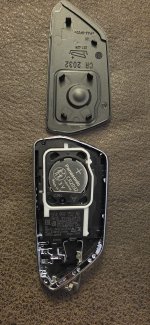

@Ice-Mark , I already tried the synchronization procedure which is little different than Google described. One importing thing is missing. The carkey has to be put in the middelconsole near the 'keyless' detection point. Otherwise the car can't be started. In my case I can start the engine, but in the dashboard it shows that the carkey can't be detected.
Btw, the car alarm goes on. It feels like you're breaking into your own car.
I will try this evening the reset procedure. For me it wasn't clear which button(s). In the Manual* I didn't read anything about this.
Update: the reset combination doesn't working unfortunately.
I have already followed the Manual* procedure.
I had contacted the dealer. May be the car key has to be recoded. The key wasn't during service begin December where I also received the PV4 software update.
Begin March I have an appointment by the dealer. I will let you known what the outcome is.
--- Problem solved :love: ---
It turned out to be the battery after all. Today I happened to come across a box of CR2032 button cells in a completely sealed package. I gave it a try. When I inserted the button cell, I immediately saw the red LED light up. Then I tested it by opening and closing the car, which worked without any problems.
I still find it strange that the spare car key needed a more powerful battery.
